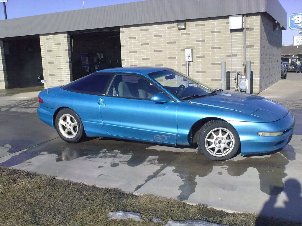

    I had the R154 Tranny all mounted up in the car, ready to make the tranny mount. It fit like a glove. Not sure if anything would have gotten in the way, like the starter, cause I didn't have one here to test fit, but it looked pretty promising. If I was going to keep the car, I would definately look into a Tremec TKO 600 tranny, but after I complete the project, I will probably pass it on to someone that wants to fix the exterior and have one of the badest 2nd gens ever! Ha Ha
    I will try to get some shots of the rear end now, while I have a couple minutes. If everything wasnt packed away in the garage I would take a few pics of the motor, lookin all purty!
    John

      Ok, Pics added. I might add some more tonight of the wiring harness, because I think I am gonna work on that(I'm not a big drinker)
      John

        Looking awesome, Rear brakes?

          It doesn't have anything back there right now. I think Matt had a Wilwood setup, and I will probably go a similar route, whatever I can find decently cheap for the nine inch....
