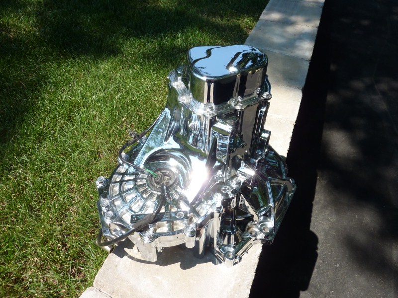

        • Hi guys, came on over here from Mazdas247 forums. I also have blown up 3 transmissions and I am now on my 4th, except this time it's got all the bells and whistles. Complete PAR staright cut gearset and quaife diff. I'm hoping this will last. Here is a quick pic of the box:
          http://lh6.ggpht.com/_ojeEHPqivho/TE...0/P1010465.jpg
          If it doesn't last, then I amy have to look at options such as the toyota box or the F40 box...
          • Nice tranny! I've seen one just like that in the Montreal area... Would it b you?

              That would be me. Where did you see it at? DMCC ?
                I too have a full set of gears from PAR, I have the straight cut synchromesh gears, I went with gears 1-5 and changed the final drive gear as well. I however decided to go with the Mfactory lsd differential.
                What options did you go with on your build and have you had an opportunity to put any miles on it yet and test it out?

                    I got the full kit, with new crown and pinion straight cut 1-4 but kept stock 5th gear. I have the needle rollers on all gears and the double sycnhros as well.
                    I have driven it, but have not done more than 500-600 miles on it yet.
                    Yes you do get gear noise, but nothing spectacular or deafening.
