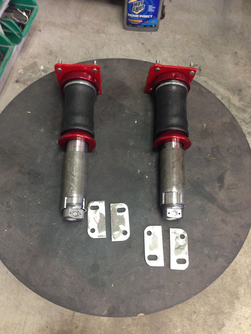

    so my car is officially bagged. I went with airlift universal sleeve over struts #75564. There is already a great thread covering the install of these struts, it can be found here: http://forums.probetalk.com/showthread.php?t=170130556
    here is a brief overview of my setup:
    airlift 75564 struts
    airlift autopilot v2 management
    444c compressor
    3/8" line/manifold
    3 gallon tank
    a few pics of the process (don't hesitate to ask questions if you have any)

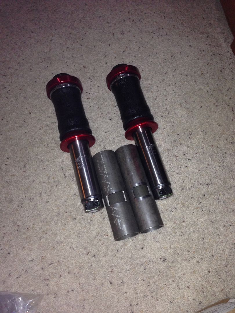

    the struts unassembled
    top mounts done

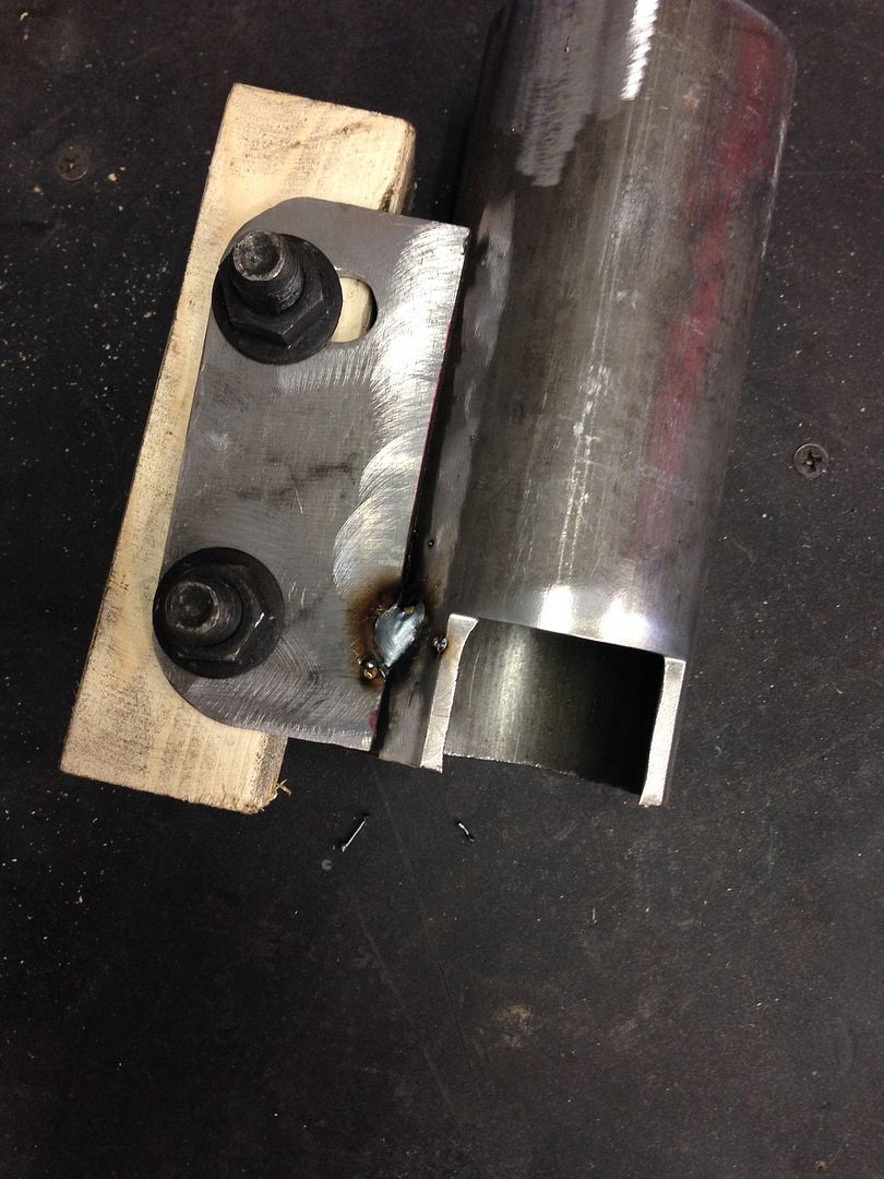

    lower mounts cut ready for welding
    made a jig to hold everything in place (excuse my tack weld, i am a novice welder at best)

          Thanks! The top mounts could be cleaner. If I had a plasma cutter it would've been great. I had to use a cutting torch and the edges aren't as clean as I'd like. I may remake them down the road. I'm extremely happy with the lowers tho! It was a lot thinner metal than the top. I did everything with a cutting torch, cutoff wheel, grinder and dremel.
